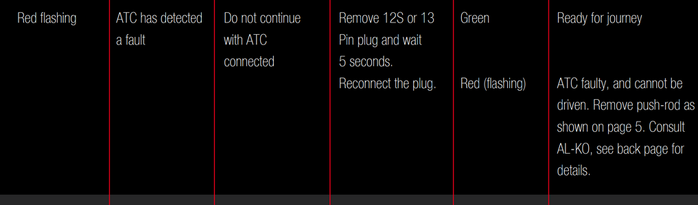

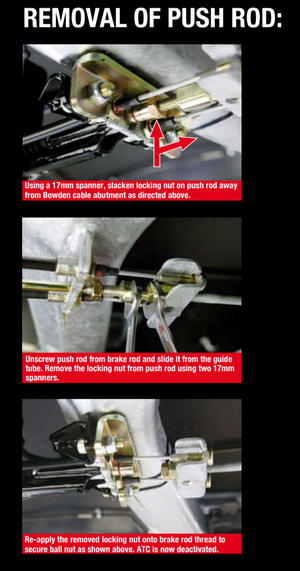

From the manual.

A steady light like that is very common. A flashing red light normally signals an error that requires the push rod to be disconnected before towing.

Flashing red is a problem and needs resolution before driving too far.

The flashing red light indicates the actuator is not being controlled and could be in a position where the caravan brakes are on to some unknown degree.
Like this it is way too risky to tow the van as even a slightly applied brake will quickly burn out. So, I am afraid it's a trip under the van for somebody to mechanically uncouple the push rod on the ATC.
