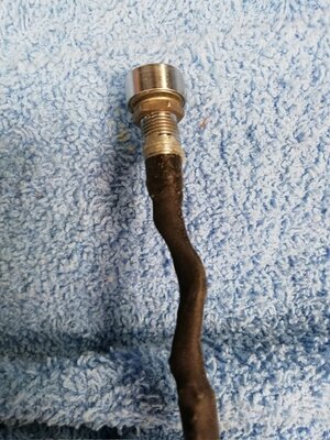

Alko ATS led
Oct 20, 2022
92
36
1,585
The led is a 2wire ,would I be right in thinking that it shows green 1 way and red when the polarity
Is reversed?
Sep 4, 2011
357
153
18,735
Correct. I obtain them from Railway Scenics website as they use them for model railway signals Fit a 470 ohm resistor in one leg wire and this stops them blowing as when Alternator is charging at 14+ volts this I’d why they blow. Never had one I have changed for many friends fail again yet,
