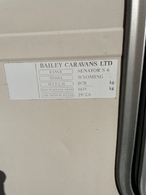

I doubt whether the true MTPLM of your caravan is 1649kg. What does the statutory plate quote as its MTPLM and what does that same plate quote as maximum permissible axle loads (not what’s on the axle labels)?

Firstly apologies my error. The MTPLM IS 1678 kgs. Hers a photo of the plate . No other plates at all. It is 15 years old.

OK. If it's 15 years old it was built before whole vehicle type approval came into effect for caravans so it won't have a statutory plate. Bailey, however, were noted for getting the details on their statutory plates wrong. They didn't seem to understand the requirements and the difference between what's on the label by the door and what is laid down in legislation.
