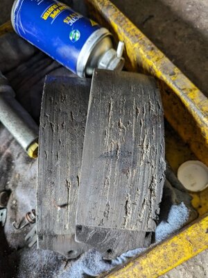

This is an often reported issue with AlKo brake shoes.
I use an Independent AWS company to give my caravan its annual service. He recently posted this picture on a popular social media site with the following comment: "We're seeing this all too often. Every caravan in the European market since around 2017 has Alko brakes. This is how they currently seem to wear, in turn destroying the braking surface of the drum itself".

A lot of the brake shoe failures like these are due to misuse. Many people leave the caravan in storage with the handbrake fully applied. The shoes stick to the drum. Pieces of material break off the shoe and stick to the drum. Worse the entire brake material parts company with the shoe and sticks to the drum. Squealing can be solved by filing a smooth chamfer edge on the leading edge of the brake material.

Handbrake being left on doesn’t cause the problem that is the picture, that is down to the compound of the shoes breaking up. Having said that leaving the handbrake on can cause them to stick and pull the lining off the shoe.
