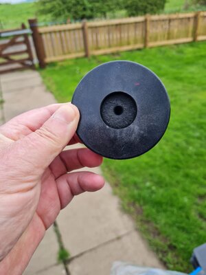

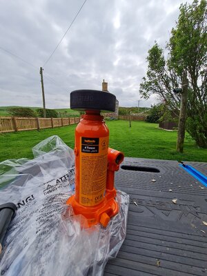

This is what I use for the car, 4 ton bottle jack with a ice hockey puck on top, should do the caravan as well, I hope.

Just make sure the bottle jack will go under if the caravan tyre is flat. I bought a low profile bottle jack after realising a standard one wouldn’t fit under if the tyre was flat.

If the caravan is too low with a flat tyre, run the wheel up a kerb or use your levelling ramp/blocks.
