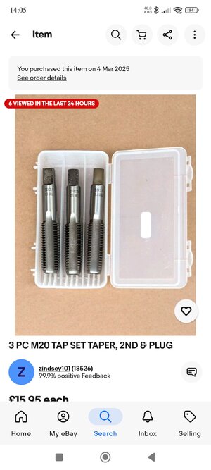

I have purchased a re-thread tap kit from eBay...£16.
Hopefully it will sort it out...

Well, just been to the van with tap set, £15.95 and tap wrench £9.95...
Lifted the van using alko jack, wheel off, re-threaded the receiver as per the video by the Cox's on You Tube...bingo!!!
Couldn't be more pleased to get the security on the van as per the Bailey standard...
