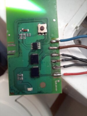

Seems our little pcb for the flush has given up? Pump was seized but that's usual. Where can the pcb, and connectors be bought from please?

Believe it or not Amazon, a lot of larger dealers, Bailey’s Prima Leisure parts,lots more on Google.
Just go for the best price. The PCB is circa £12. Pump £45 ish.

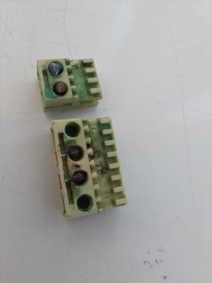

All fixed now . The Micro switch is now working as it should, odd little thing as everytime over winter I had to enter the caravan, I just give it a push. Must have decided to play up these last weeks or so. The Live Red wire had also become detached so back home and I decided to cut the wires off one at a time and soldered directly to the pcb. Connectors gone beyond saving.
