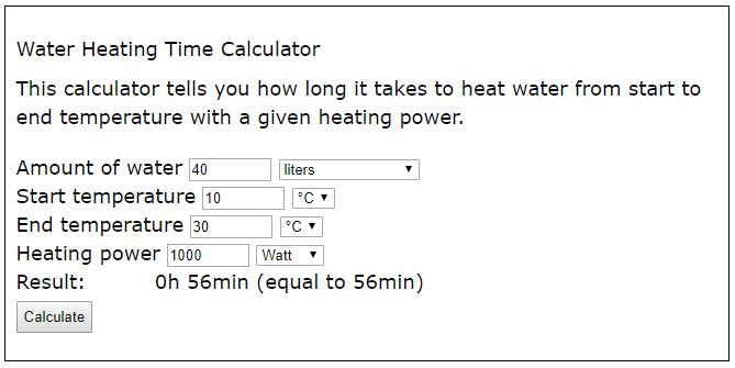

So back on my favourite topic, van shower hot water.
May I clarify, I know many people use site facilities, others don't mind short showers and for all I know some may not shower at all, so it would be great if interested parties could restrict comments to the technical aspects and viability of getting an increased flow of hot (30 Deg C) water to the shower so it lasts a lot longer.
One way I am considering is to simply place a heating element in the Aqua Roll to raise that water from say 10 Deg C to say 30 deg C.
Have a look at these calcs and give your opinion in principle about trying this.

That's another way, but from a practical point of view adding 1L of boiling water to 40L at 10C will only raise the water by about 2.5C. so to get it to 30C would need about 8L. - It all seems a bit over the top literally as the full water container would indeed over flow.
