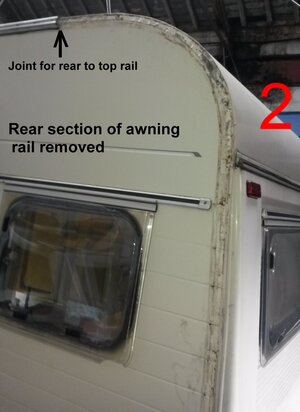

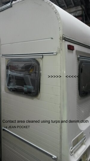

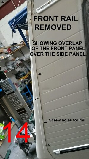

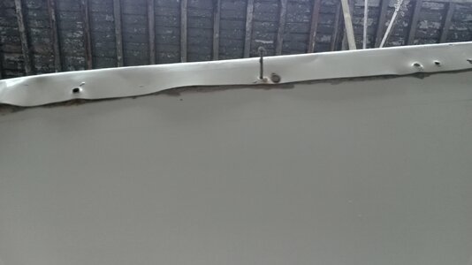

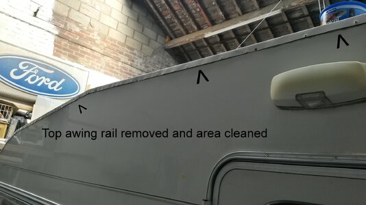

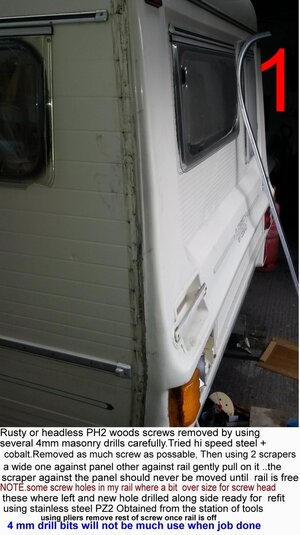

I thought these images of my abbey gts 212 may be of interest..
