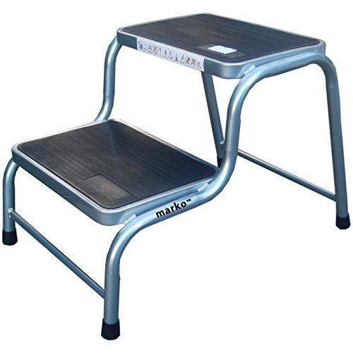

For Gagakev, I looked at that step and checked it against one on ebay, which was actually 30mm higher than the Milenco, so for obvious reasons I went for that. Same here, we carried an ali stepladder in later months but this new step makes all the difference and such a simple thing too. This is the step I went for, height 420mm as opposed to Milencos 390mm
The thing I did notice in the video is that the guy puts the awning up from the back, his logic being that once around the corner its virtually holding its own weight. Thats the way Im going to go for, fingers crossed. Starnge to think that all these years the awning has been a struggle, but with a bit of out the box thinking and getting out of deep ingrained mehtods, there may be light at the end of the tunnel for us shorties.
