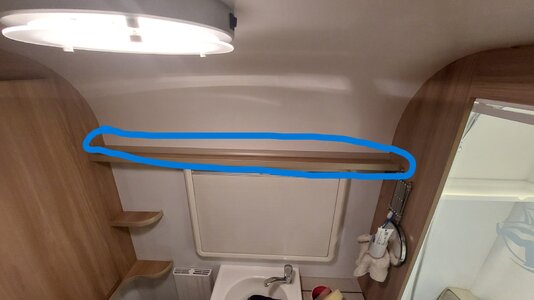

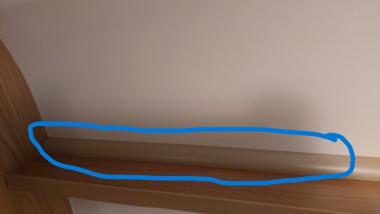

Anyone know how i remove this cover - Bailey Madrid, 2016, rear bathroom above the shelf. I need to access the wiring behind it.
Is it just clipped in place? Don't want to pull to hard in case it's screwed/glued and I break it.

I think they click on, sort of opposing zig zag style, if they are like the shower trim they are great fun 🤔😂😂
25,491
9,314
Use a plastic trim remover or a thin kitchen utensil (fish slice,spatula) and gently lever up.

thanks - it worked. i got the hair dryer on it to warm it up a bit first, then it clipped out after a bit of effort, then clipped back in again.
