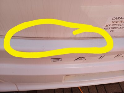

Here is a picture of the fender above the rear panel. I'm thinking of just removing and using Sikaflex to seal?
5,848
2,770
The fenders are not for weather proofing. Water will get behind them and it shouldn’t be a problem. They are cosmetic. But also offer a cheap fix if they are damaged say by stone chips. I replaced a front corner fender on my Valencia, in a few minutes for £110. A repair to the caravan front would have been far more.

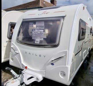

Hi I don’t know if your front handles for dragging / pulling the caravan about are high up but they were on the Pursuit so I took the panels off rather than risk them being brittle and shattering which with my luck it would have happened, it was the same as this picture the Jive is a Pursuit 2
