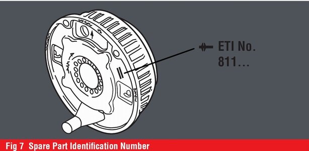

On the early drums the embossed digits on the casting are on the outside of the drum on the rough surface that isn't machined
