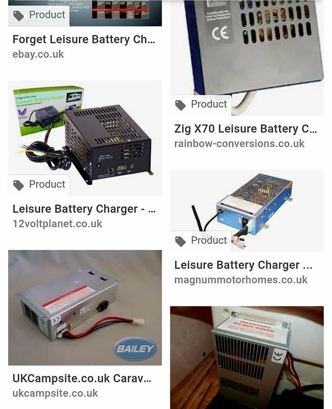

24,114
8,471
It will probably be underneath one of the front seats, could be in wardrobe but unusual. Follow cables from the EHU input and track them to the power supply box/charger. Then you should be able to identify the charger make/ model.

Had a look under the front seat, bit out of my depth now.
Lots of wires and boxes.
Going to get an expert look at it for me.
