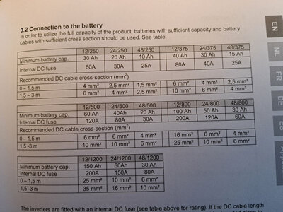

As per the attached picture I am not sure what they mean by Minimum Battery Cap? The Victron inverter came with no cables whatsoever.
It seems the customer has to make up the cables? Probably need to buy a 2 metres of 1.5mm cable, 1m of each colour plus a fuse holder and fuse. Unfortunately when purchasing the unit there is no mention that it does not come with the cabling like most other inverters. A bit annoying!
1.5mm is only good if you have a 48v inverter
6 or 4mm minimum is what's needed.

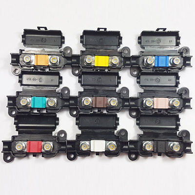

Anything over 30amps and I use something like this.
Despite the title it does go to 150amp.
Needs lugs on the cable.
Using the link by JTQ I managed to source the fuse and fuse holder. Next issue is trying to get suitable cable at least 6mm in diameter plus the crocodile clips or clamps. However as the cable may be 2m in length maybe the 10mm would be better? Not sure of search terms to find the correct cable as Amazon doesn't seem to have anything suitable that is at least 1.5m in length although I would prefer 2m.
I must admit I never thought buying an inverter could give me so many complications. LOL! The last time I bought an inverter ti came with all the cables etc.

Are you sure the cable is 6mm diameter that’s a thumping big cable. Could it be 6mm2?
Victron flexible cable can be supplied at 6mm2 and 2.0 m
Thanks. Almost got the incorrect size. I looked at the chart and assume it was 6mm and not 6mm squared. As the cable could be up to 2m in length then perhaps 10mm squared would be better. However by the same token it is unlikely we will ever draw as much as 10amps even when using the unit in the caravan?
