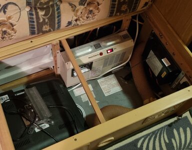

Evening all, hoping for a bit of advise. Photos generally to show space I have. Caravan has been empty/out of use for 6 months. It's only a work home so it's an old 2002 (maybe) 2 berth. The external battery compartment is tiny (gives space for a battery max 33 x 18 x 23) I was looking at upgrading from the current 60ah. Add to this, that it charged for 12 hours yesterday and today wouldn't even give me a light on the 12v panel... I'm looking at what work would be involved (and is it safe) to add a battery to the under seat area inside. I'll find out after a 24h charge if it's a dead battery, me leaving something on, or a short somewhere.
If I have to replace it, I don't just want a like for like, but anything I can see over 100ah I don't think will fit in the external battery locker

From the picture you have added to your opening post, it seems you have a fairy typical 230Vac to 12Vdc power supply/charger that uses a Switched Mode converter. These produce a regulated 13.8Vdc which will run the caravans internal 12V items when you have and recharge an LA battery on good condition safely. As you have a caravan mover, and if you want to use it, you must have a battery to provide the current the mover needs.
You tell us you need 12Vdc off grid capability for a week. This posses more of a challenge, and you will definitely need a good battery, and skills at being economic with your 12V usage. Energy saving tips such as changing all the lights to LEDs, making sure you turn everything off when your finished with them, be wary of the things that continually sip power over longer periods, like lights, modern TVs, are much better than older ones, but they can eat a surprising amount of battery charge.
You might consider getting a 100W solar panel which over most days (even cloudy ones) can make a usefull contribution to the battery charge and extend the off grid capability by a few days.
Be warned, if you are off grid, the battery may be down on charge by the end of your stay, and it might not have the energy to run the mover.
