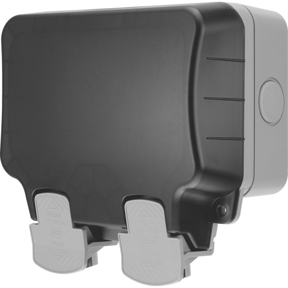

Just to add to Plodds advice you don’t need an EHU socket outside. Get an electrician to fit an external 3 pin 13 amp socket and you can the connect your caravans Electric Hook Up (EHU) cable using an adaptor this allows you to use the 3 pin 13 amp socket on your wall. The link below shows what to use. They are readily available on line or from caravan /camping outlets. With mine after connecting I wrapped a plastic shopping bag around it and then used Duct tape. This reduces the probability of water ingress.

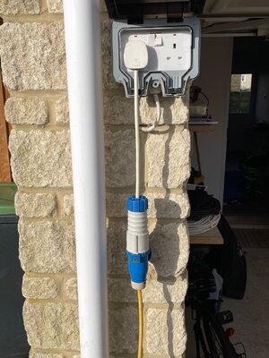

Mine in the flesh this morning. Not wrapped but all cables securely watertight with sealing glands in built.
I agree with Mr Plodd . A fixed bed and TV! Plus a functioning chemical toilet.
look at Covenants and neighbours . Use propane gas especially in winter months

The Apuljack adaptor in my link doesn’t show that it has a sealing gland. Perhaps you could give the OP a link to a seller of yours. Cheers

No chance . It’s 20 years old!😜
K&M make a similar one (Amazon) but do not quote its IP rating. There also the boxes that you clamp the two connectors in to, they are IP44 splash proof.
K&M
Adaptor box
PS there are quite a number come up on Google searches that claim IP44 but looking at them I am not so sure. Hence why I adopted the Sainsbury's bag additional covering on mine :ROFLMAO:

The OP is planning on the caravan being in situ for an extended period of time. So why not just fit a socket that is actually designed to do the job in question
No need for plastic carrier bags, concerns about the gland around the cable being watertight., or the need to add in an additional adapter.
Safety must be paramount, thats why caravan sites use the connectors that we all see, rather than a splash proof 13 amp socket being advocated by some. They are fine for occasional use, but in this case we are talking about many months.. Either way the costs are similar, so why compromise?
My caravan is alongside my house, I have fitted the correct EHU socket to connect itvto when required. I also have splash proof 13 amp sockets on the outside wall of the garage to supply garden machinery etc.
Different tasks, different equipment.

You have read into my post precisely what you want to read. Nowhere did I mention a splash proof wall socket, as that would not be my recommendation anyway. The wall socket should be IP66. Why do you also feel the need for “ bold” so often , I’d venture most members are more than capable of comprehending what you write.
IP 66 wall sockets are readily available from recognised manufactueres and outlets, viz
I note your ABB socket is IP44 splashproof.

Nice one👏👏. Another job on my list. Never thought to look for one.🥴
