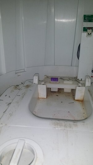

Remove the toilet cassette from its compartment. Look to the very rear and you will see a small fuse. The fuse holder connections get corroded in this hostile environment.
Remove the fuse and clean the holder contacts with emery paper and electrical contact spray. Use a new fuse or clean the existing making sure it hasn't blown.
99% it's this fuse holder that causes the problem . See the photoIMG_1206.jpeg

Ours is the newer toilet which doesn't have the fuse at the back of the toilet, it is wired to the fuseboard directly.
There is no 12v power to the toilet at all, I traced the lack of power back to where the wire comes up into the cassette housing.
Now I just don't know where that cable is dead from.
Birdman above has helped in regard to which cable is the main one coming up into the housing, I just can't get the trim off which the wire comes out of...
