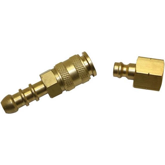

https://www.gooutdoors.co.uk/15901719/cadac-8mm-quick-release-coupling-15901719
This quick release connector is great.
May 24, 2014
3,687
765
Thanks Hutch, I was looking at those. They also do a double kit but its the wrong way round. Two to attach to the Cadac and only one male insert.
12,081
4,245
It works well, had it for about two years now, save having to unscrew the connection pipe, its shorter than the screw on legs.
May 24, 2014
3,687
765
I got two of the QRs. One to connect pipe from Cadac to caravan, inline connector at caravan end, and t'other on short pipe with propane regulator to use on patio with the caravans bottle.

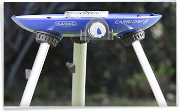

All gas BBQs can be susceptible to wind, depending of course on wind strength and direction. Firstly, you should be using the domed lid as a windshield unless using it as an oven. Secondly look closely at the control knob, its highest point is in the centre of its travel, its furthest travel being the equivalent of simmer. People often turn them down thinking they are turning them up.
If indeed it is a weak flame, I still would suspect a faulty jet, another issue could be a faulty regulator, be it on the caravan or bottle. Is the hose tightly clamped at both ends, is there a split in the hose allowing gas to escape and pressure drop. There really are a multitide of things it could be, but Im totally in support of the opinion that if its brand new, take it back and have it swapped. Have you spoken to Cadac tech support at Clitheroe?
If you look at the pic below, the highest flame would be at the 9 o clock setting.
