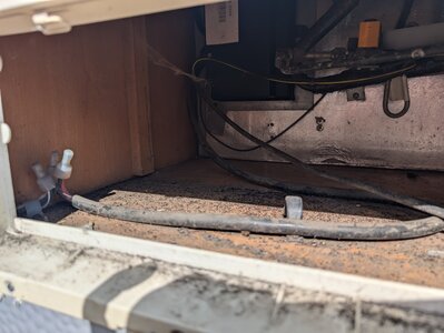

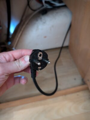

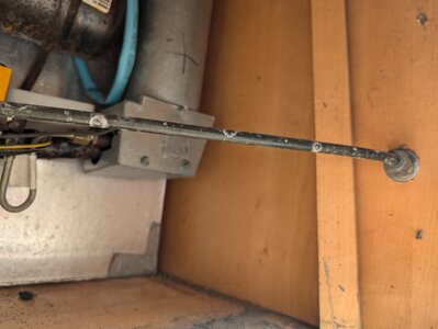

I have recently purchased a 2006 tourer caravan. The fridge freezer is broken and needs removing. It's connected the gas, with a European plug and some electrical wires. I'm assuming the wires connect to the tow hitch. I need to remove the wires, but I want to make sure that they are safe. Would they need to be capped and put in a junction box? Pictures below for reference.
Thanks in advance

Gas.
Ensure internal fridge specific gas tap is off . Once pipe detached ensure it is correctly capped with a blind end joint.
12v. Should be a simple connector. Or cut the wires and insulate +ve and -ve.
230 v. Just unplug the standard three pin plug from the socket.
As Buckman, what’s wrong? Doesn’t it it work on any three power sources ?12 v whilst hitched up on the move.
