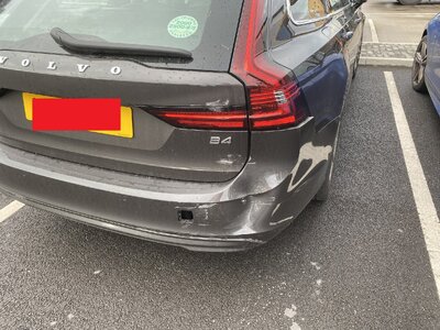

I'd only had my current V90 for six weeks when this happened (hit & run) in a hotel car park:
Once I'd calmed down I got a quote from my local smart repair place, he's also into classic cars and knows how fussy I am about repairs, he promised me I wouldn't be able to tell and repaired it for less than my insurance excess all within a day. As others have said, some well meaning touch-ups end up looking worse than the actual damage. Although the VIN paint will give you the colour code, some manufacturers use several shades on that colour, remember the Vauxhall Cavaliers from the early-mid 80's done in China Blue (a kind of mid-powder blue)? FOURTEEN shades to that colour!!!!!

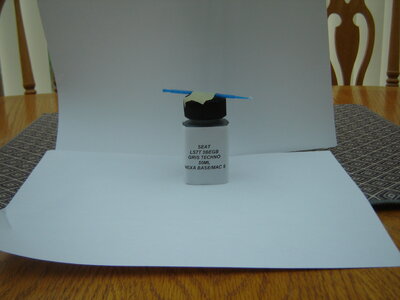

After i rung the paint shop they deal with 7 manufacturers and right back to Italy
it part of a old and new colour mixed together and they are waiting for the new formula it will be available later in the year
So he got his camera and did a match and i got this below
50ml paint and lacquer mixed together for £8.75
