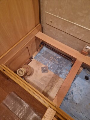

So recently we had a damp check carried out on our van and there were sky high damp readings (99% in places) in the rear O/S floor. Never picked up before, even on the service 6 months ago! Anyway because of the age of the van. The cost of repair was not worth it... so I thought I'd have a look myself.
I've cut out some sections where there are damp readings of 30+ and so far everything seems okay. The batten on the side is readings below 20% and the ply under the polystyrene is dry. It just seems to be the top bit if ply? Most of which I've removed.

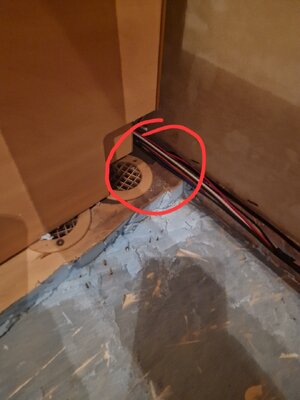

Question is... there is a tiny part I can't access to cut out and it is located right behind the toilet. Will a small bit like this dry out? If not... any advice on how to deal with this? I've circled it in red in the picture.
We're unsure where the damp is coming from, the engineer suggested the low rail on the O/S but wouldn't that mean the batten would be damp too?
The toilet hasn't been used at all... so maybe the cassette locker?
Any ideas or he'll greatly appreciated as always!
Thanks all
