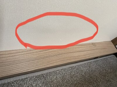

2022 Swift Sprite Major EB. Just noticed some delamination of the inner skin in the bedroom. It’s a shallow blister 10” up from floor level, about 9” long x 2” wide, it “gives” when pressed so clearly delaminating from the sandwiched inner core. The Swift group use GRP inner and outer skins, outer skin looks fine.
It’s going in for it’s first service at the end of next month so obviously I’ll discuss with the dealer, but does anyone have any experience of delamination repairs other than floors?

Fortunately the manufacturers warranty is 3 years for structural defects but I emailed them photos earlier. Just curious if anyone else has experience of this as I can’t see how it can be fixed without injecting adhesive (which would leave a hole).
I don’t know about the delamination but I suspect it can be fixed with adhesive. Re-decoration is a realistic concern.
My dealer made a mess of the wall behind the toilet when the van was about 3 years old. After I complained, they had it in a re-surfaced the wall. It looked as good as new.
We had our Lunar done for delamintation. They drill underneath a few small holes depending on the size of the delamination and then pump in some gunk and then cover the drilled hole.
Seems to be a manufacturing defect where the glues weren’t spread properly before compression of the boards. Shame. I doubt it’s life threatening but does question the integrity of the whole panel. Yes it can be fixed virtually invisibly if they are careful. However the long term is something I’d want a written assurance from The Dealer and secondly Swift that any further issues will be addressed even if the entire panel has to be replaced, ie the whole side!

Just to give an update on this, despite struggling to take clear photos of the delamination problem, Swift have accepted it is faulty and will be taking the caravan back to the factory to sort it. They'll need it for 10 to 12 weeks so hoping they take it back soon so we don't miss any holidays next year.

I know what you mean, being an engineer I naturally want to know what the problem was and how it’ll be rectified! The dealer has said they’ll ask Swift for an appraisal when they’ve got it back. I’ll be adding a discrete mark to that side of the caravan so I’ll be able to tell if it’s had a new side or been repaired in-situ.

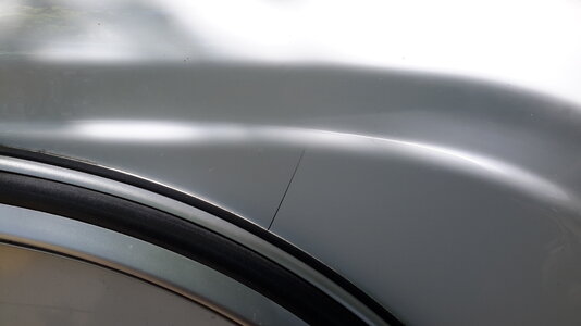

When I had a rear panel replaced by Coachman for cracks from the awning rail. They resealed all the roof and windows, But they would not commit to why the cracks had happened from the awning rails, but hinted that it was due to not having pilot holes drilled for the awning rails. 20160812_134248.jpg
