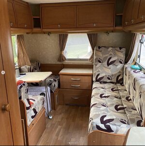

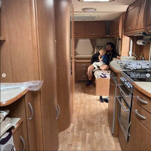

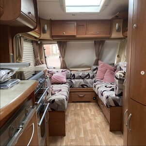

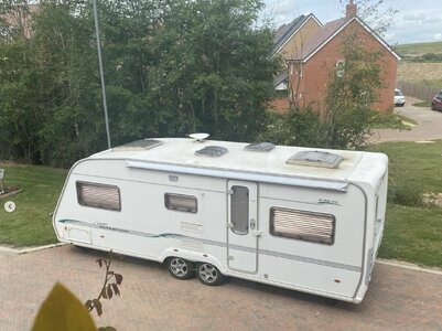

So we bought a small Bessacarr Cameo 635 gl 2005 caravan with an idea of rebuilding it.
Our budget is about £5-6k, some of the work planned is:
  • Re-painting cabinets, drawers, etc
  • Re-painting the exterior
  • Throwing out the shower cubicle, adding a dishwasher instead
  • Rebuild the back lounge - adding bunk beds and a fixed bed
  • Perhaps cutting couple of side windows in the back
We plan to use it as a holiday home (we are a family of 5) stored in Europe , which we will tow through different countries throughout the year. Using serviced pitches only.
To a certain extent this is a "we don't actually know what we need in the end and what it will require to accomplish" project so any advice/suggestion or sharing a similar experience is greatly appreciated!
This is how it has started about a month ago
(folks from another resource have seen this already, starting the thread here to get more opinions / suggestions)

Two thoughts. Cutting windows in places they were never intended to go will most likely weaken the structural integrity of the van.
A dishwasher will massively dig into the weight allowance and will probably worsen its towing characteristics.
But the best of luck to you.
20,092
5,346
Every one to their own but a dishwasher🥴. They use a lot of amps during the heating cycle!
16,413
5,252
Not sure of the layout, but a dishwasher anywhere in the caravan is going to have a severe effect on stability of the caravan never mind it reducing the user payload severely.
As said cutting to add windows may not be a good idea plus moving and changing furniture around as it is the furniture that gives the caravan its structural integrity. It will also affect the stability of the caravan. Not sure whether a Certificate of Competence would be required due to structural changes which may cause it to become unroadworthy in the eyes of the law?
If towing around Europe insurance may be a prerequisite and probably essential never mind the fact that you are restricted to 90 days in any 180 day period unless you have a visa.
6,187
2,255
I agree and European sites can be rated as low as 3 amps; so worth thinking about.
However, sounds like an exciting project. Keep us informed of progress and al the best with it.

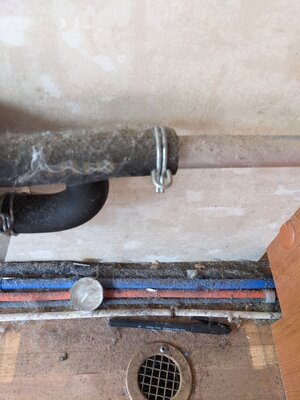

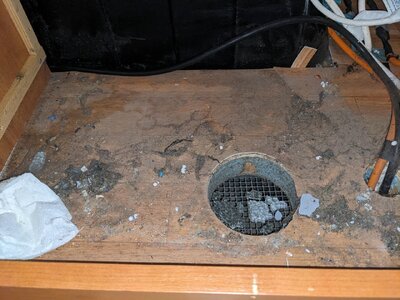

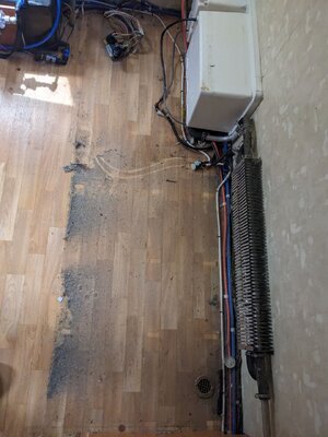

Appreciate all the comments and concerns raised!
As the caravan is old, there is a lot of dirt/dust, especially in places that are hard to reach. All vertical and horizontal surfaces are going through multi-stage cleaning process - spraying vinegar solution, spraying alcohol solution , Dettol spray, final clean mopping .
This is under front beds:
This is under the oven - no idea what shattered glass is doing there??
12,409
4,573
The shattered glass, probably from an oven door, we were finding bit of glass a year or two later after we broke one.
6,187
2,255
Or someone closed the cooker lid when the burners were on?
Looks like a major clean up operation. Very satisfying once it is done though.
