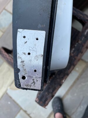

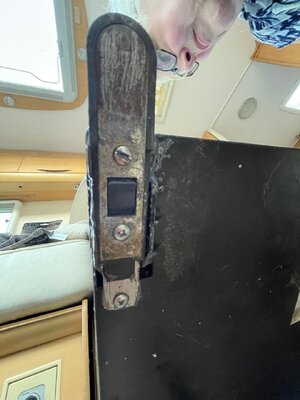

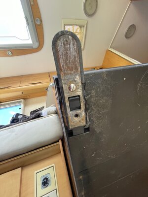

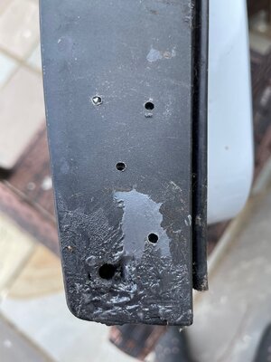

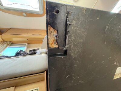

It had to happen. The door finally fell off. You will see from my photos the thin plastic of the fridge floor and the door itself carry all the weight of the products stored inside the door like bottles etc.
You can buy door hinge repair kits , top and bottom at £30. + each end. Sadly none available until July at earliest.
The hardest part was repairing the fridge floor with a metal Doppler plate and lots of JB Weld.
The door hinges were easier making up,my own metal plates , JB Weld , self tappers .
Removing and refitting the fridge was not easy. The gas pipe didn’t want to refasten. A bit of careful fettling and post testing for gas leaks all is back in working order . Next time GSI. Get Someone In😉.
