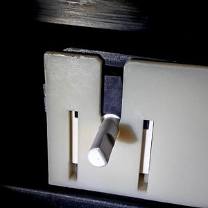

It will need pulling forward to access the switch and remove the top cover of the switch to access the thermocouple contacts to clean the grease off the contacts , which is stopping the thermocouple current flowing.

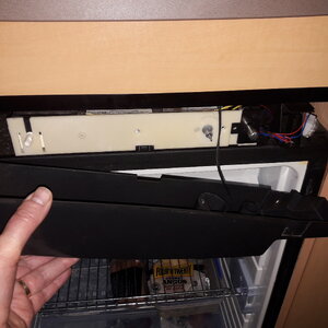

I visited the caravan a few days ago, and removed the 4 screws which hold the fridge in place, and was able to pull it out a bit. Not far enough to fully remove the cover that covers the fuel selector switch, but enough to lift that cover enough to pull the fuel selector switch out. I didn't have time to short the thermocouple terminals you mentioned, with wire, and test it, but now I have the switch at home.

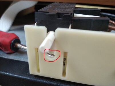

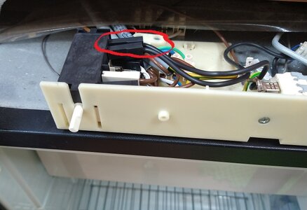

I've taken it apart, which looks like this, and removed the thermocouple contacts (6a & 6b) which look like this close up.
With a DMM set to ohms, I can't detect any resistance around any of the contacts yet, but could you please confirm the main area I should be testing - is it where I have the screwdriver pointing in that last photo?
I assume that yellowish grease is there for lubricating the part which is contacting (apart from the spring which also contacts). Do I just remove all that grease from the contacting area? If so, what is it meant to be greasing?

If there is grease on terminal probably dielectric grease, helps protect against corrosion and lube mechanism. Worth applying some more sparely at assembly if you have some.
Removing reassembling maybe enough to make dodgy contact work. Give all the contact points a clean with isopropyl alcohol and gentle rub with pencil eraser. Reassemble test a few times by switching between positions..
Before reinstalling, short two wires from fridge going to switch's gas contactor terminals. If switch was problem fridge should run on gas.

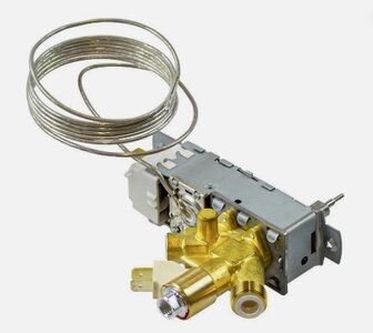

@Tel7 Yes remove the grease from the hinge and also the two contacts. As per previous posts the grease is the issue( Extract from google re dielectric grease " Dielectric grease properties include being a non-conductive, silicone-based compound that insulates electrical connections, repels moisture, prevents corrosion, and lubricates while resisting extreme temperatures, ensuring electrical integrity by sealing out contaminants without impeding current flow at the contact points. Key attributes are its high resistivity, water repellency, and thermal stability, making it ideal for spark plugs, bulb sockets, and connectors.)
So even a thin layer between the metal parts will increase the resistance enough to prevent the thermocouple holding in the gas valve solenoid. Removing it with IPA will solve it . The mains and 12V heaters both run through the selector switch, and no the thermocouple does not affect either the mains or 12V heater circuits. The gas valve dial does however have a temperature sensor 'bulb' (gas filled) which does interrupt the mains heater , when the temperature in the fridge is low enough,dependant of the dial setting See photo . The contacts are on the left side of the attached photo . If the bulb and pipe to this thermostat is damaged ( loss of gas) it will register as a very low temperature and may interrupt the current to the heater. Also you will need to check the resistance of the main heater element you are looking at about 400 ohms ish
