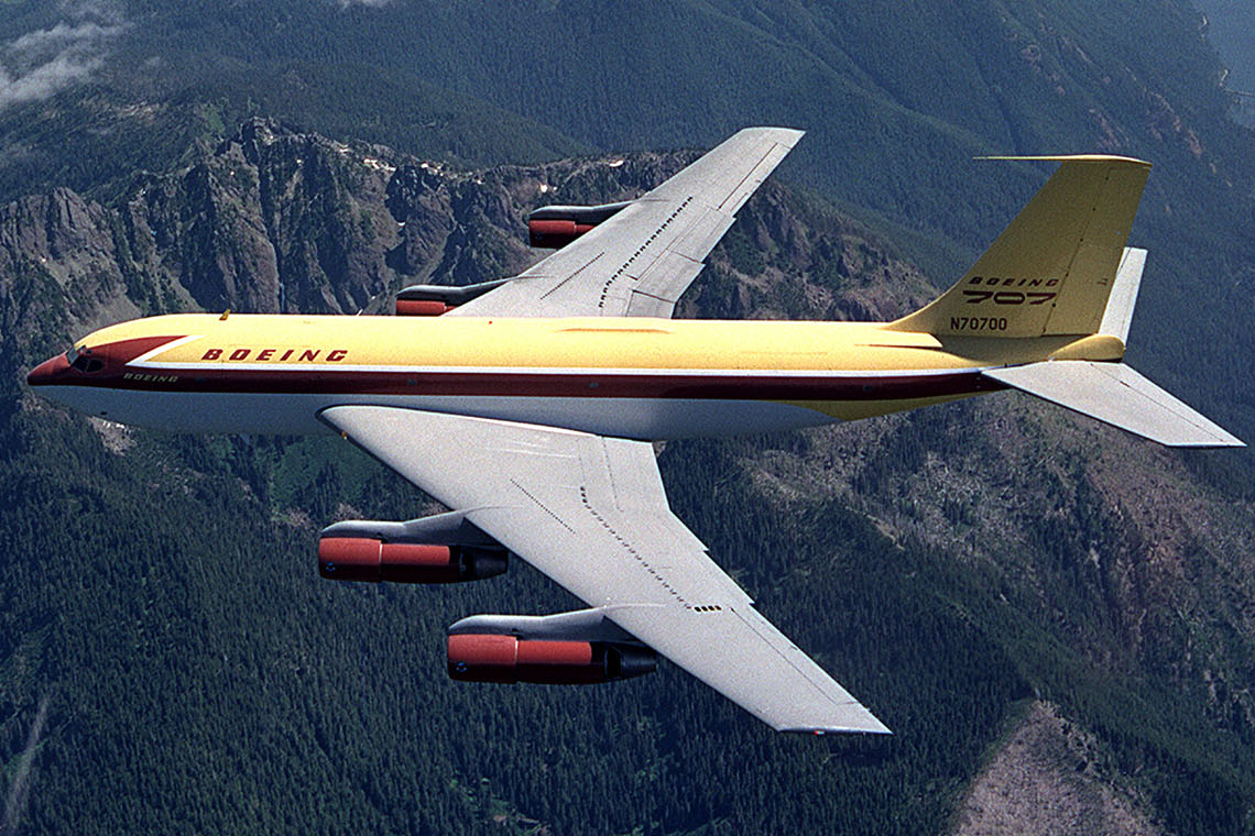

You are talking entry in to commercial service but the 707 prototype flew in 1954 at close to the time of the Comet disasters. And that’s not AI generated.Those comments are at variance from my knowledge and what I have read. It is well documented the Comet commenced flights in 1952 and the 707 in 1958..

The Comet prototype flew 5 years earlier - given the pace of development during and after WW2 the 707 was a generation further on.You are talking entry in to commercial service but the 707 prototype flew in 1954 at close to the time of the Comet disasters. And that’s not AI generated.
Boeing 367-80 - Wikipedia
en.wikipedia.org

Comparing like with like the first Comet flew in July 1949, and the first 707 in July 1954. It was designated Dash80, or 367-80 but had 707 painted on its tail plane. It’s now in the Smithsonian along with many other interesting exhibits.Thank you for getting us back on track.
