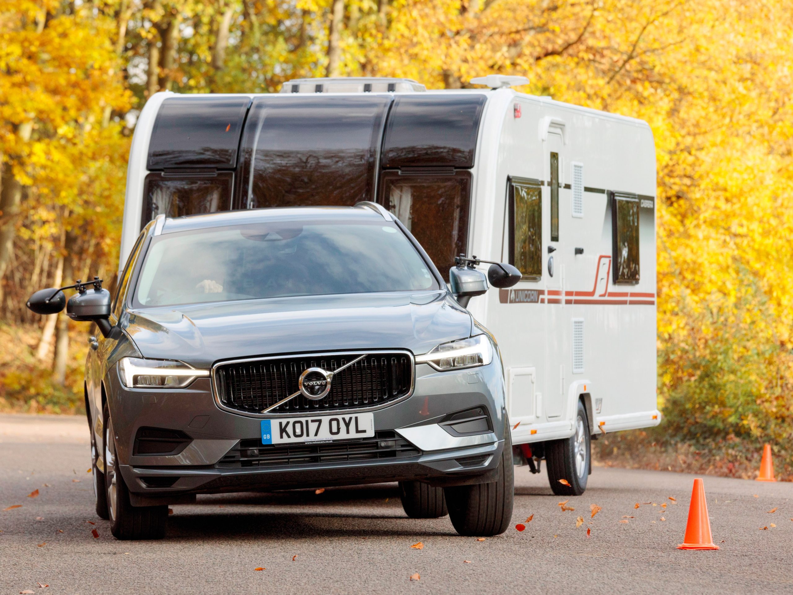

Worth reading the Prac Caravan review of the XC60 testing the R-Design model. (march 2018)
The kerbweight quoted is 1836 and the limit 2400. However it is the actual kerbweight that should be used which means that the max 1711 of the Elddis is actually 93%. The 85% figure is a guideline only. so this higher percentage may well be comfortable doable and safe with the right towcar. A Bailey weighing max 1532 was used for the towing test in the report.
The maximum towing figure is a technical figure that I think is related to a number of unit restarts on a steep incline. The towing limit is a chunk above the kerbweight which is always a good sign.

I can vouch for the xc60, we use the wife's to tow out van and it is not a problem at all very stable and comfortable .
1800kg swift we tow.
