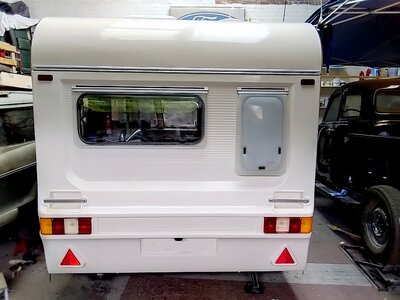

On my 1992 Abbey which has a GRP front and ABS rear panel,that if removed the rear panel would expose a timber frame,it incorporates the rear lights and the outer window seals,it is held in place by the awning rails either side,stapled to the underside of the floor and the top of it is behind the lateral roof rail,I therefore don't consider it a major structural component,the front GRP had faded due to age but as it has a pigment included in the gel coat resin elbow grease and autoglym products restored the Sheene.
The ABS rear panel may not be structural but it will be subject to flexing when the caravan is towed due to the lightweight construction of any timber frame underneath - if/when it cracks it would allow moisture into the timber frame underneath.
As a tangent, balancing the road wheels will reduce the flexing considerably but not eliminate it completely.
Assuming the ABS panel is still the original it has done remarkably well compared to many more modern caravans.

Perhaps it may depend on factors such as material thickness,stress points recognised and taken into consideration when designing the panelabbey n cab.jpg

Perhaps it may depend on factors such as material thickness,stress points recognised and taken into consideration when designing the panelView attachment 8245
Some continental caravans continued to use that configuration where the roof curves over the rear and forms a horizontal joint with the ABS panel. Rather than having a full height ABS panel that then has the horizontal joint with the roof on the roof itself.
Its "integrity" most certainly impacts on the van's structural integrity.
Any loss of its watertight integrity is highly likely to lead to the wooden structural parts rotting.

Only if damaged surely,which applies to any accident damaged panel
It does not need to be "damaged", it is very capable of cracking without any accident, it can simply fracture from a multitude of stressing states.
From as pointed out earlier screwed fittings, particularly where done without clearance holes being formed, or from stapling, these all very capable of causing stress raisers. Then, from locked in stresses caused during the actual moulding. Plus from embrittlement over time from UV exposure, where its once ability to accommodate flexing is sufficiently lost.
