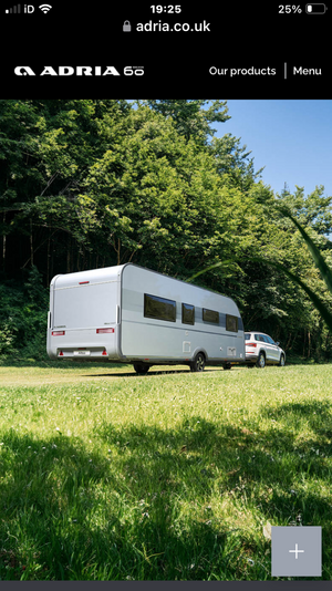

Some continental caravans continued to use that configuration where the roof curves over the rear and forms a horizontal joint with the ABS panel. Rather than having a full height ABS panel that then has the horizontal joint with the roof on the roof itself.
My 2009 Adria is same construction. With ABS panel being rear wall water ingress isn't as bad as it would be if panel was on roof where water can pool at cracks. eg Eddlis and Swifts.
No ingress yet but I might do quick check for cracks in panel.

Adria continued that design feature and it still features in their 2025 models. So do Knaus with Sudwind and Sport. Dare say probably Hymer and Defleths too. Wonder why UK builders departed from that style. Form over function or cheaper/lighter? Who knows.
