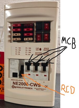

The water heater and space heater ( if separate units) and the battery charger are all permanently connected to the RCD ( the bit that trips) if you have a combined water/space heater combi 4e or Alde unit that also will be connected to the RCD , even if switched off , the neutral is connected and if there is an earth fault the RCD will trip. To isolate the fault, switch off one of the MCBs at a time ( see attached photo showing the MCBs and RCD )and try to reset the RCD , if it resets then something on the circuit the MCB feeds is faulty, if not switch the MCB back on and try the next . This will allow the rest of the 240V system to continue working. The MCBs are two pole which isolates both the live and neutral wires . The interesting thing about the RCD and one on on the hook up post is they are both rated at 30mA and its 50:50 as to which trips first.Once you have determined what the MCB that causes the trip , you can then find the faulty appliance . It will probably require the services of a caravan engineer to repair the faulty appliance.

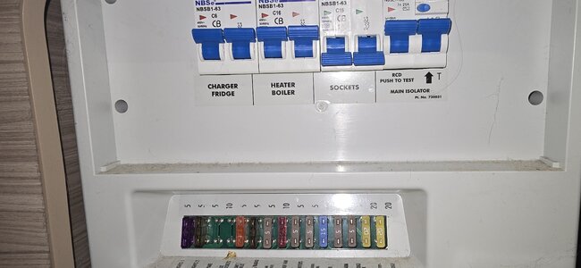

No, they are wired directly from the MCBS you have three MCB's , the left hand one does the charger and fridge mains heater supply , the centre one is the 13A sockets and the RH does the water heater and space heater.
Are you saying that the system as shown in your photo is working with the sockets MCB set to off ? i.e.
1. The RCD is ON and the charger/Fridge MCB is ON and the water heater/Boiler MCB is ON
2. The centre MCB marked 'sockets' is OFF.
3. No external appliances are fitted to any of the sockets, go round the caravan and double check.
4. When you activate the sockets MCB it trips the RCD?
If thats the case , then there is an internal fault in the mains wiring harness, again you will need an electrician /caravan engineer to check out and rectify the fault.
Yes. I was thinking it might be a internal wire issue. Many thanks for your help.
