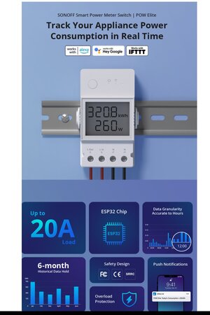

What (watt) meter is it & how does it attach?

Its This Sonoff 20amp meter/switch, din rail mounted it has a display but since I mounted it in the consumer unit I just use the app/web interface. I can read it from anywhere provided my caravan wifi is on.
I just slid the mcbs/rcd along cut a longer slot in the faceplate and fitted blanks to cover the meter.
Power now comes in through it and to the rcd.
I use a similar item to control my immersion heater at home
