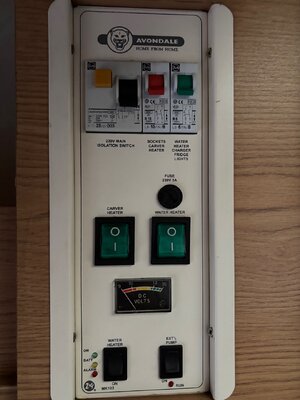

Why have i not got ceiling lights, side lamps, toilet flush, or fridge getting cold? I’ve attached photo of the box with switches I’ve the turned off now

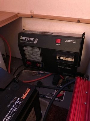

As Borderbilly has implied the year of the caravan might be significant. Avondale ceased production in 2008, so your caravan will be at least 17 years old, And Birdman's comment is also valid.
Below is a picture of a 2004 model year electrical distribution system as fitted to an Avondale
This is a combined package that has the 230v ac mains circuit protection parts on the RH side and the 12V fuses to the left. It also has a battery charger built into it. The fuse Birdman mentions is usually fitted to the Battery positive wire close to the battery.

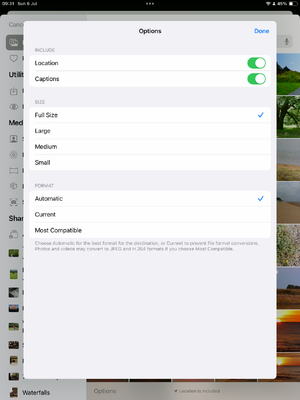

If you have iPhone as you select photo from Library there’s an option to reduce size. I go from Original to Large. Once selected you can carry on with Upload.
As you go into photo library press options at the bottom left and this screen pops up.. Select your size and then press Done.

Thanks for the photo. Some caravans of your vintage have both 12 v and 230v lights. What are yours?
Do you know how to use a multimeter to check all the cables section by section starting with the positive battery cable?
