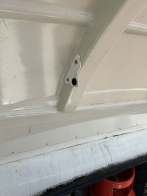

Have this hook type thing on the inside of my front storage. Should there be or can I get a bar to hold the front open. It’s where the gas/spare wheel is stored.

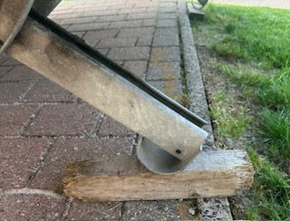

I then have these legs. Is that just how they are with it being an older van? I’ve seen a lot with black feet as such.

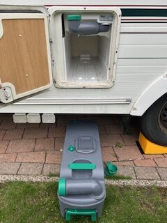

Finally I have this Thetford cassette C-420C R. Can I check what the top filler is for that’s on the caravan, not the removable cassette. Is it to fill the toilet as such?

Top filler is for flush water that you use after using the cassette. My last caravan had nothing to hold the front locker open. It was my neck and back that did that role.
Whilst we refer to this toilet water as "flush" water, it is nothing like we know as an WC flush, best thought of as a means to wet the bowl pre #2s and ease off any deposits left post use.
If treated as a WC flush the trip will be spent emptying the cassette.
I mention it as that is what I discovered a newbie family were doing, or trying to.
