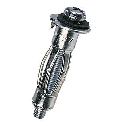

as a qualified caravan service technician i have always used the 2nd fixings (metal cavity fixing) when securing items to the walls. and no problems
Reactions: Scarymamma
4,638
I always stock up on them when in France as they are readily available in Hypermarkets
They call them chevilles or something similar
They used to be cheap but who knows how much cheaper now that the Euro exchange rate is poor!!

I have used Bond Tight for exactly the same weight extinguisher (however the base is resting on the van floor) - works a treat.
