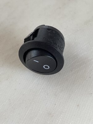

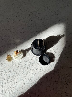

You will see on another post I had trouble with my interior 12v lights .
Testing the circuit section by section ,it was the 12 v master switch that had failed. A replacement fixed it.
