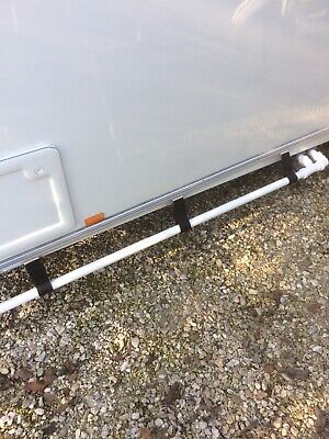

This is my waste pipe setup, the bottom picture, all parts available from Wickes or most DIY stores its 32mm plastic pipe and push fittings. I have four 1mts lengths and the last section is a 40mm with a 32mm pushed inside to make a variable length extension ( a bit like a telescope. You can make the hangers from spare awning skirt or 6mm wooden dowel, a bit of webbing strap (handle of a morrisons bag) and some velcro. Handy if you have a sewing machine but can be hand stitched together they are also available on ebay. I use a standard whale connector to my caravan inlet and also have a separate spare extension for if the tap is a little further.

I have done the same with the push fit piping but our Buc doesn't have entries for the lower groove on the offside-so I have bought some 32mm pipe clamps and poked a tent stake through them-i shall then hammer them in lower and lower to create a fall and clip the pipe into them! Can't try this yet but i have lots of heavy duty awning stakes and the clips were 99p each so notmuch to waste!

That's a really good idea saves mucking about with pegs and bits of wood etc. if your caravan has a side awing groove.

If you dont have the side awning track you can just use suction hooks from Wilko or (best ones are from IKEA)
