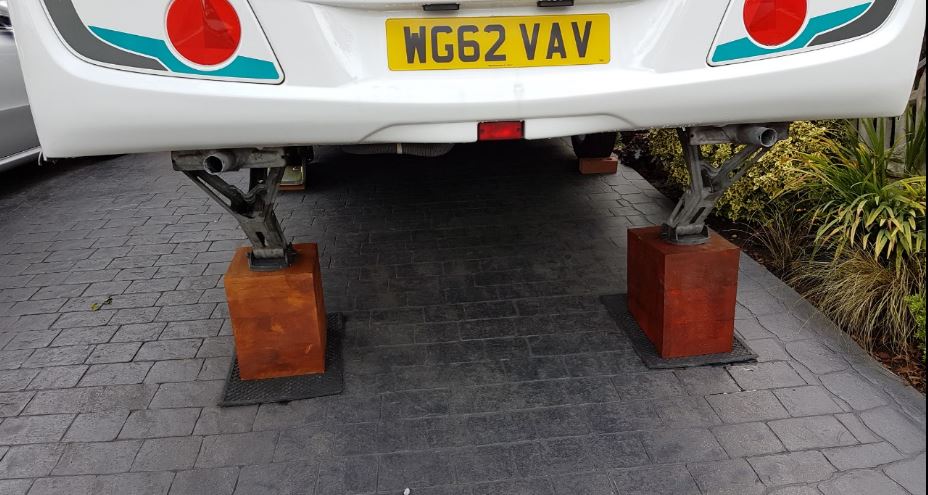

In my case, handbrake on, rubber chocks, MM off, Bulldog wheel lock on, and as you can see I have a steep drive. Never had the handbrake stick. I worry that leaving the MM engaged will compromise the tyre.
