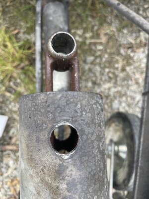

I have driven it twice now and I have a noise when braking and pulling away. On further research I believe it to be the damper, although I’ve been told it may be the brakes.

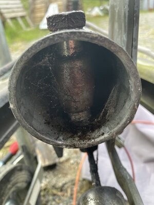

I watched a YouTube video that had a guy simply remove the front and rear bolts and the damper simply pulled out. I have done this and it is freely moving, to an extent, within the shaft but will not come out.

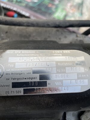

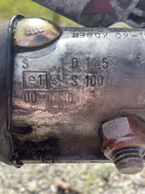

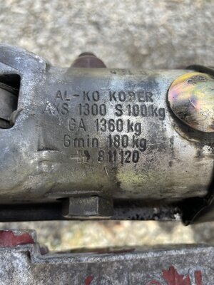

Also in one of the pictures you can see the larger side of the damper and it looks like nothing I can find online.
Can anyone help me remove the damper and identify what I need to purchase as a replacement.

Is there a nut on the opposite end of the damper? On mine the shaft was threaded - bit of a pain to get to.
As for a replacement, hopefully there will be a part number on the damper itself when you remove it.

On the one end it turns indefinitely without doing anything and the other end is ether unbelievably stiff or doesn’t turn as I cannot get it to turn.
The damper will move enough to bring each end out of the enclosure something is stopping it coming out. I cannot find a bolt and I have had as good a look as I can down the shaft using a torch and cannot see anything obviously blocking it.
