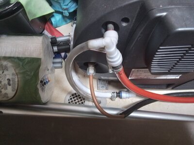

If your caravan has a combi boiler be sure to check the drain down relief valve has a length of plastic tubing running from it down through the floor. My 2019 Phoenix was missing it from the factory. Some while later (years) that little valve sprung a leak one night (grit under tge valve seat I think) and a lot of water leaked out into the caravan rather than exiting through the pipe and outside. We discovered it one morning because the carpets were soggy.
I had to take all of the vinyl flooring up as the water had got between it and the floor. All the vinyl under the seat, across the lounge, under the sink cupboards and halfway back down the caravan, nightmare!!
If that has happened to yours, and the flooring wasn't removed then the water has/had nowhere to escape.
Such a simple thing,but caused me a lot of work! Of course it was impossible to prove it hadn't been fitted at the factory, so no chance of a warranty claim :(
It's the clear tube coming out of the side of the white valve with the red pipe feeding into the bottom of it. The clear tube exits through the floor.
Just a thought, but worth checking.
Reactions: Annie3
That’s not the drain down valve per say, that lets air in while the drain down valve is open (normally (in caravans) a yellow lift up leaver (I know you know that Mr P)))
Nov 30, 2022
2,021
1,930
5,935
And if you read my post you will see the words "drain down relief valve"
Jun 6, 2006
1,040
260
19,435
The drain drain valve has a relief valve built in (pressure), the hot outlet you picture is to let air into the boiler to allow free flow when draining down, so possibly the terminology used that lead me to my post 🤔
