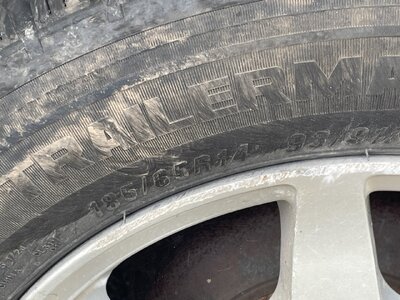

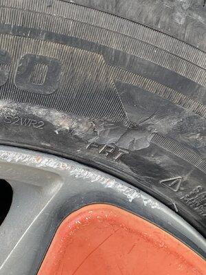

Back on Wi-Fi for a moment. Somewhere on the A417 in Herefordshire this happened. We felt nothing but conclude one of the numerous pot holes was responsible. Proving it is nigh impossible. Is it worth a letter to Hereford Council? Probably a waste of time. Mobile guy out tomorrow £80.00😢 Some may say looking at the photos the tyre is fine. Not worth taking a chance. I don’t know what damage may now lurk beneath the rubber.
The death knell of a caravan tyre is the UV exposure and standing still for long periods. My AWS looks at the inner and outer walls for signs of cracking. Any cracks they get changed
