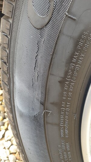

Just got our van back after 8 months in for repairs and found this.
Tyres are five years old, at max pressure (65psi) and been stored in the shade. They will be replaced before our first trip.
The van was first registered in 2020 by which time the tyres were 2 years old.

I'm guessing from that bit of the logo they're ovations? Just thrown some away for the same thing both outside and on the inner tread. Looks like they cooked yours when applying the logo.

Just re-looking at the issue on the Ovation tyre up there ^^, i actually would suspect that your tyres been left flat for some time at the dealer. The location/nature of the cracks is just right for sitting on the rim for a while, and it looks a little deformed too which makes me suspicious.
They're not great tyres though, probably no loss now you have to replace them. Before you do though, roll the tyre round so the cracks are at the bottom, then let the air out and send us a picture 😉

In this instance I'm inclined to agree with the previous post, where the pattern of the damage suggests the tyre lost its inflation and may have sat on its rim. If that is the case, then I don't think even the most expensive tyre would have survived undamaged.

it serves no practical purpose in this case
The purpose would be to inform the rest of us whether these tyres simply failed to make it to their 6th birthday, or whether there's a reasonable explanation.
As someone who buys a few thousand OE tyres a year for manufacturing, I can tell you there are wild quality differences, but often marginal price differences. I can go from a manufacturers cheapest tyre to their most expensive in under $10 price variance. A tyre retailing for nearly double the RRP could be a dollar or two price difference at OE pricing. Of course you cant just spend 10%/20%/50% more across the board buying better everything without increasing the prices by the same, but when you would be spending $25 or $30 per tyre to go from budget to mid spec, $10 or $20 seems well spent on an item that is one of the most basic safety features of the vehicle. The could maybe apply less graphics that will instantly look out of date to the 'vans instead to save some money!
If the OP chose to take that up with the repair shop that would be up to them, although it certainly might inform as to whether to bother using them again. You don't need an ISO certification to maintain basic standards.
