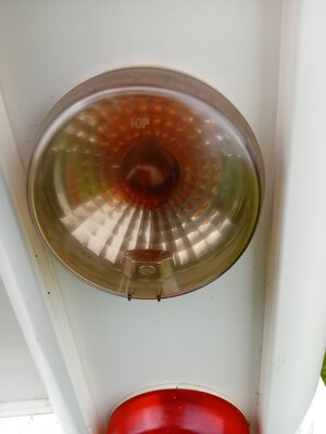

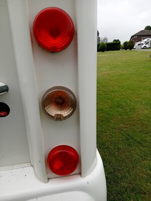

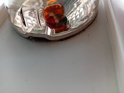

As suggested by IanB1485 I have taken photos of the rear lights. There are no screws visible and no access from inside so I am assuming that the covers on the lights are a push fit but am reluctant to insert anything in what I believe is a drain hole in bottom of lens cover 1000003191.jpg1000003190.jpg1000003190.jpg

got this off caravantalk forum back in 2011
  • Push a flat screwdriver into the recess at the base of the light.
  • Gently prise the bottom of the light unit out whilst pulling in a downward movement on the top of the light.
  • The complete unit will now pull away from the rear panel
  • To refit is simply the reversal of the removal.
the poster who asked about how to remove them did struggle as they were ve tight in the holes in the rear panel, Good luck
