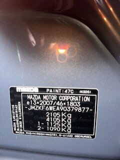

Just to clarify, many cars have a generic user handbook that covers a range of models, rather than one specific model. Consequently weights, measures and limits can be difficult to unravel from the general text. The fact is each specific model can have its own set of load limits which might be unique to that one model. To be certain, you need to see the vehicles weight plate which defines four specific limits for each car
The four limits are
Line 1: The Gross Vehicle Mass or Maximum Authorised Mass
Line 2: The Gross Train Mass (the maximum mass of the car and trailer weighed hitched together)
Line3: Front Axle Maximum Load
Line 4: Rear Axle Maximum Load
(If line 2 is empty or set "0" the car you have chosen is not approved for towing)
These are strict legal limits with no tolerance. At no time should you load in excess of any of these static limits.
A simple calculation of Line 2 - Line 1 will tell you the maximum allowed trailer mass you can tow when the car is fully laden.
Just becasue you keep within these limits does not guarantee your outfit will tow safely. That is down to how you load and drive the outfit.

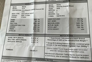

As stated above, I am considering using my CX5 2ltr 2wd to tow a yet to purchase caravan with a mtplm of 1624
The cars plate states,
Therefore 2000kg.
However Mazda put an 1800kg limitation on towing. This is for all models, 2020 on so not sure where the OP gets 1800 to 2100

Do not confuse the weight limits as conferring safety to an outfit. Safety is about correct secure loading to achieve a suitable nose load, and sensible driving habits. and proper maintenance of tow vehicle and trailer.
A car and trailer that is loaded correctly can still be driven recklessly and be a danger to self or others.
Follow the advice I gave in #6 about vehicle weights, that is the law, and you must only use the plate related to your vehicle. A similar model may be different and has no lawful application to your vehicle.
The 85% figure is an advisory figure and has no law backing it, but it does hint at the sensible approach of always using the smallest trailer possible for the job in hand to keep the weight of the trailer as small as is reasonably possible. You must still keep all weights and load within the cars stated limits, regardless of any advice that might suggest otherwise.
Therefore 2000kg.
Given the information on the data plate you have shown, which as you correctly state the difference between GTM and GVM is 2000kg, that prescribes the towing capacity when the car is fully laden as 2000Kg, and that is what the law would see.
I understand that, but worth pointing out nevertheless.
