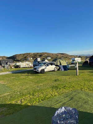

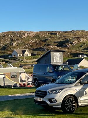

The Scourie Caravan site is first class for a Sky or Freesat signal and has been for the last 20 years. Talking to the Clachtoll site owners they can’t even get terrestrial TV. The transmitter for the area barely covers 50 homes in Lochinver and the very nearby area.
Here’s a photo of the hill, not even a Munro! Doesn’t look much but on the other side the slopes look worse to me especially the road from Lochinver to here.
But many thanks for the technical input , it really is appreciated, thankyou.

16,803
5,433
That hill, Cnoc nan Cnamh, is about 500 metres away from the campsite - at about 70m high and converting the 18.4 degrees to 0.3211406 radians, a dish at sea level would only need to be 218 metres away to clear the hill.
Obviously a site I dare not visit. LOL! :ROFLMAO: :ROFLMAO:
