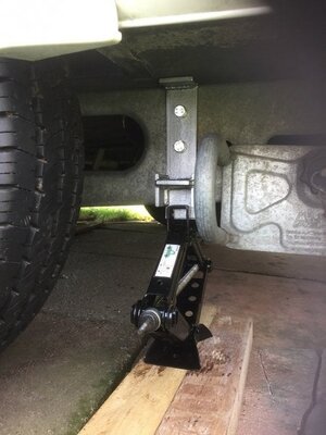

The little brackets which fit onto the trailer have a round bar on them , the Kojack jack has a mating round 'hollow' ( see photo) this allows the two parts to 'lock' together. A 'normal' bottle jack doesn't but has a serrated flat surface , so may slip off the bracket ( particularly if not on the level). your choice

If you are already carrying a Bottle Jack then just place it under the reinforced bracket where the axle fixes to the chassis.

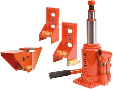

Here is the Kojack bracket, it is the same as the Alko heavy duty one. One point is that you real need the van to be as close to level by raising the nose on the jockey wheel to get a safe lift.

You can still raise the nose with the car attached to the van, if the nose of the van is low , you will not get a safe lift using the Alko or Kojack jack points. I fully agree about raising the flat wheel by using ramps.

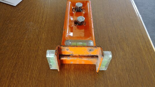

Strangely Hutch my 15 year old Kojack brackets are different, triangular compared to my original Al-ko which as you know failed dangerously. The oems were straight brackets that when under load collapsed and bent through 90degs. At the time Kojack brought out their triangular heavy duty brackets which for me have worked safely with no issues.
The following photos are like mine. I can’t find now the originals of the Al-ko failures.
Weren’t the ones that failed L shaped 1000 kg. These have been replaced by triangular 1000 kg brackets. But the 800 kg ones are still L shaped., although both types share the same fastening holes why buy the L shaped when a triangular 1000 kg is superior.
No . They were dead straight and bent L shaped when they failed. I posted photos years ago but can’t find them today.
Cannot link to the pictures but found your old posts wrt the failure. The brackets fitted were marginal at 800 kg on your caravans weight.
