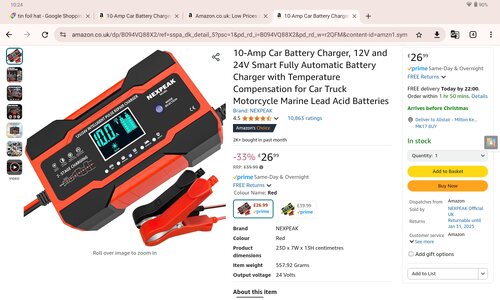

I decided last week to treat myself to a new charger, so I bought this one
Nexpeak , 10 amp on Amazon
I have tried it on my two batteries and the "repair mode" seems to have done it's job . One battery after being off charge would drop to 12.65v after 12 hours. Now after 6 hours on Repair, after 12 hour rest it now sits at 12.95v
But recovered with what percentage level of capacity?
The loss of capacity, effectively what batteries are all about storing energy, is what renders most to the salvage bin.
Have you tested to be able to comment on the new chargers ability to reset after an on charge mains power cut? This aspect might be of interest to others deliberating on charger purchases, certainly those living with overhead mains supplies.
Interesting price for what is a powerful domestic charger.

I haven't tried all the aspects of the charger yet, having only bought it last week. It feels slightly light , 1.26lbs (560 grms), the cables are quite short.
Time will tell if my purchase has been worth it.
To be truthful, I don't get many power cuts here and Charging my batteries would be one of the last things on my mind.

Hutch, would you mind putting your multimeter on it and measure if it actually outputs 10 amps, much appreciated if you can confirm (or otherwise).
Bestest
At the risk of stating the obvious, my apologies if so.
To provoke it to push out its rated current the battery would need to be in a state requiring the charger to sense it has to adopt its "bulk" charging rate, be that the battery's SoF is low enough, you are very lucky to catch it peaking a pulse or it can be dragged down by a load it is providing.
Interesting would be the voltages it achieves during the absorption, float and long term caretaking phases, and in the latter does it actually drop to a zero positive current.
These values could well be specified in the manual it may have been provided with.

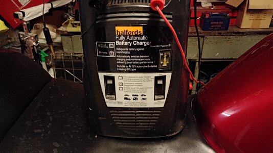

That still could be useful if ever you had a battery go really flat that a more modern charger with smart technology could not sense what in needed to do, ignore it or assume it was a 6 volt rather than a 12 volt.
My son in law has it just in case of an emergency.
12,698
4,841
That is exactly, what I have done, my 20 year old Halfords charger, has a 20 amp fuse, and it charging voltage is a max of 13.5.
Bestest
Sir Haggis, I put my batteries on charge today, but individual, they only drew 2.8 to 3 amps charge, but considering they were almost at 12.9 volts the current charge is not surprising.
