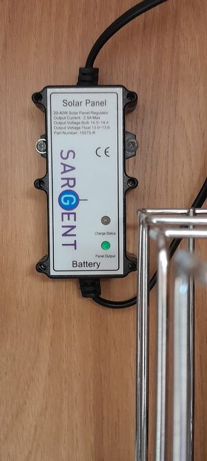

All I know is there are no lights on this at all, I don't know if I have a solar charger as such or how this thing actually works.
My service engineers told me as it no longer functions the best thing to do is to disregard it.
I'm on a permanent ehu all season and don't go off grid.
I'm going to remove the battery and stick it on the AA, 4 amp charger that has been suggested.
But thanks for all your input peeps.
