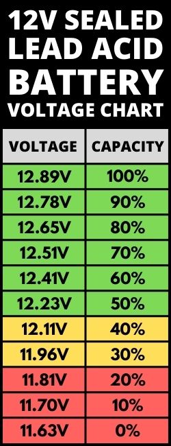

As Plod suggests, I'd be sceptical about a meter that read exactly 12V when testing battery, really you need a bit more precision such as meter with at least 10th's of a volt.
I also agree if its able to power the mover then it can't be all that bad.
If you are connected to the mains 230V ac and the caravans battery charger is working, the voltage at the battery terminals should be closer to 13.8V.
If you disconnect the battery (so nothing is drawing any current) leave it to stand for about an hour then measure the terminal voltage , the table below should give an indication of the state of charge.
