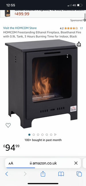

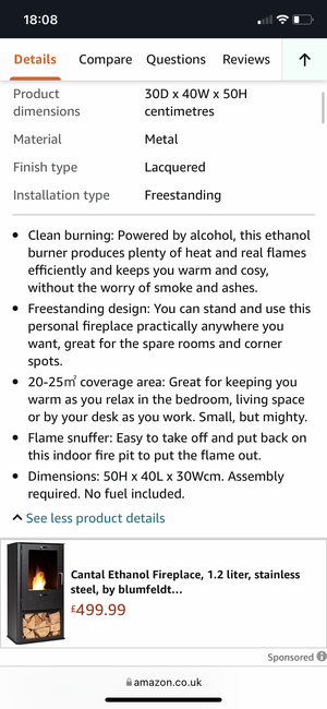

I heard they are fumeless inside fires. That run off bioethanol?

They are not fumeless they only claim smokeless which is a very specific claim.
When ever a fuel oxidises (burns) it extracts Oxygen form the air and leaves various other products such as Carbon Monoxide, (CO) Carbon Dioxide (CO2) , and Water vapour. (H2O) Each of these displace the available oxygen and can effectively suffocate in small places. But the worst is CO which is called the silent killer with good reason.
  • DO NOT USE THIS TYPE OF HEATER IN A CARAVAN. I CANNOT EXPRESS THE DANGERS ENOUGH.

I appreciate your concern. But why would they be allowed to claim for indoor use? And small work spaces. Living rooms. Etc.. most reviews seem great. But you now have me wondering. Would burning the gas with the truma not be the same?

A caravan heating appliance has a flue which directs the harmful fumes away from the interior of the caravan.
We can't tell you what to do, but the Prof is right, CO2 inside a caravan can be deadly.
I wouldn't take the chance.
No, the Truma has a sealed flue so the products of combustion do not enter the caravan.
